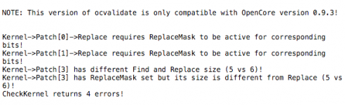

I had a look at your EFI and found out it had the following errors under the Kernel > Patches section:
Anyways I've updated and corrected the mistakes (which also includes misplaced kext loads as well as adding missing .efi essential drivers).
Give it a try.
