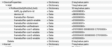

It is more likely to be caused by the DeviceProperties you have entered in your config.plist for your UHD 630 IGPU.
Screenshot 2022-04-15 at 19.18.41.png DeviceProperties for IGPU
  1. These entries are missing the framebuffer-con0 device, which I find strange.
  2. It may be that your laptop needs the Framebuffer-con0 device to be included, even if it is a 'dummy' entry.
  3. It may be that the Alldata entries for con1 and con2 are not correct.
  4. Where did you get these IGPU entries, from someone else's setup?
  5. Have you tried booting without the framebuffer-con1 and framebuffer-con2 entries?
  6. What happens?

I got the values myself but don’t remember how I did it. These were the values I used for my set up when I had Big Sur installed and it never caused me any issues. I think I added the con1 and con2 values so I could connect my monitors to the HDMI port.
Yes they are both set for a HDMI connector, see the centre 8 numbers '00080000' this is the setting for a HDMI connector.
That sorts out an external display connecting to your laptop via HDMI.
What about the main laptop display.
That may be an eDP or LDVS connector, it needs to be set correctly so the connector doesn't take an age to start displaying the OS.
Open your IOReg, look under the IGPU and see what is shown for the @display0, or better yet post a copy of your IOReg so I can see what is happening. Use the version attached below when making the copy.
Do not connect any external displays when you make a copy of your IOReg.

2,350
I need to see the whole IOReg, not a partial screenshot of a section of the display section.
But seeing that section I can tell you that neither of the framebuffer-con1 or framebuffer-con2 entries are doing anything useful for your laptops main display.
The main display is connected to framebuffer-con0, which you omitted from the DeviceProperties.
Did you try booting the system with the framebuffer-con1 and framebuffer-con2 entries removed/disabled in the config.plist?

Good to hear the new EFI worked for your system and got the internal display working.
You may need to remove one of the VoodooPS2Controller plugins for the trackpad to work as a Trackpad and provide gustures in macOS.
Usually I have to remove or disable VoodooPS2Mouse.kext in my config.plist for my laptop hacks. This is in order for the Trackpad to work as a Trackpad, and System Preferences to enable the Trackpad pref pane. Where the Gestures can be enabled and amended to suit your requirements. Otherwise the trackpad tends to work as a very basic mouse.
I can confirm that your IOReg shows your Internal display uses an LDVS connector <02000000> not a HDMI connector, as is set in the new /EFI/OC/config.plist provided by Middleman.
  1. You may need to use the framebuffer-con1 and framebuffer-con2 entries from your previous config in order for the HDMI connection to the external display to work.
  2. The framebuffer-con0-alldata entry is missing from the new config.plist. It is provided for the other two connectors, but not for the internal display.
You need to undo whatever changes you made to the EFI and its contents to get your system booting again.
