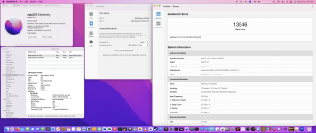

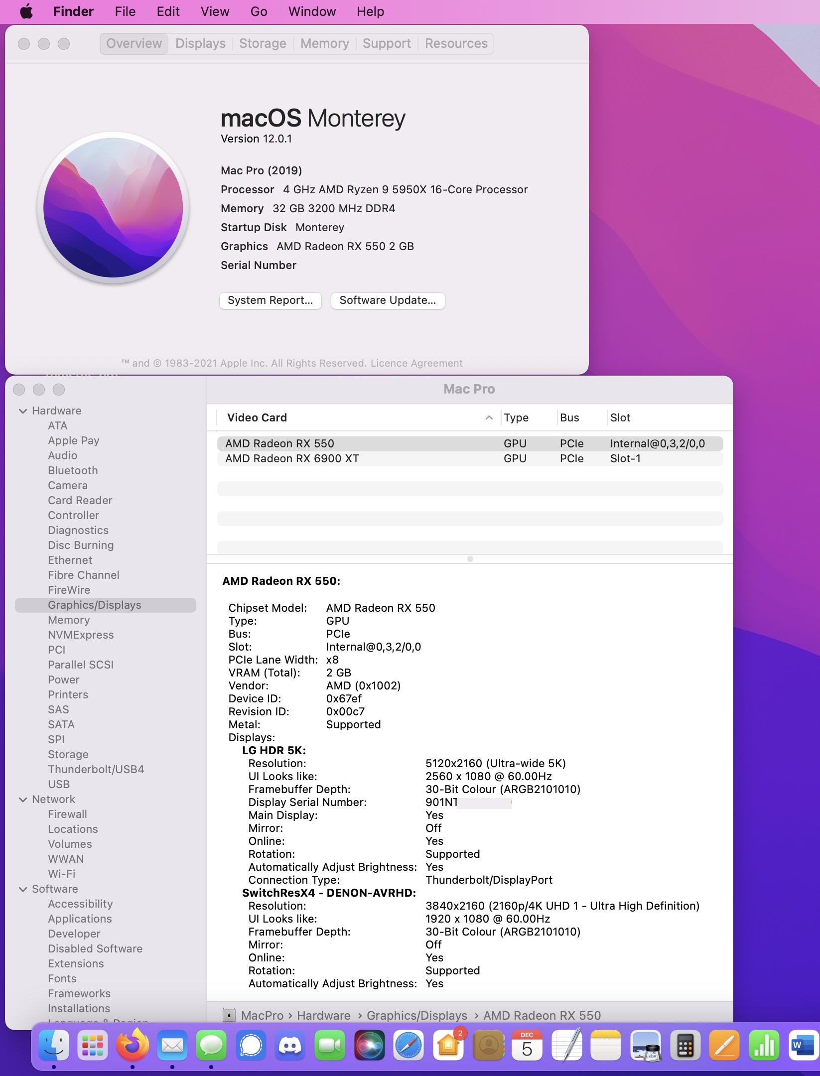

Last week I installed Windows 10 32bit as dual boot on my first hackintosh from 2012, a 4th gen Intel. I wanted to play old Windows 95 games natively and they work well even with Windows 10 but required 32 bit in order to have full support also for 16 bit apps. It had only iGPU and grabbed an Saphire Radeon RX 550 2GB Gaming from my shelf and was suprised there where no support for it for Windows 10 32bit, only 64bit. However, I took the latest 32bit driver pack and manually installed the most most closest driver, RX 455, that was within the 32bit install kit. To my suprise it installed and worked like a charm.
I have had a need to get a basic and silent adeon card for my Mac Pro 2010 at office with OpenCore Big Sur so I thought the RX 550 maybe could be spoofed to MacOS as well. First I tried with the old 4th gen Intel with Clover and Mojave and it worked well with an SSDT spoofing the RX 550 to 0x67EF. Next I wanted to try it with Big Sur or Monterey and did not want to wait getting to office but instead tried it on my AMD rig with Rx 6900 Xt and wanted also to learn how to manage two egpu's within OpenCore. It worked in AMD Montery well (without WEG), but only with the port I had attached at boot (no port without any dispaly at boot), so I thought Whatevergreen will fix the video ports, but the spoof did not work with WEG. Third step was I wanted to try putting the rx 550 device-id spoof within Opencore Deviceproperties instead, but the result was the same (no spoof).
On Sunday I did find out that I have to disable the automatic spoof built into Whatevergreen in order to make a selfdefined spoof, so I added "no-gfx-spoof = <01 00 00 00>" and it works great now in my AMD, 4th gen intel and my Mac Pro 2010 at office. The HDMI (and Displayport) sound kind of works but is very distorted, and I want to still fix this too.
Is this something new that we can get RX 550 Lexa based to work in OpenCore? I can make a publication of this if this is the case.
Please find screen shot from my AMD rig with a 4K + LG wide 5120x2160 combination with RX 550, full 30 bit colors + HDR + 60 Hz.
