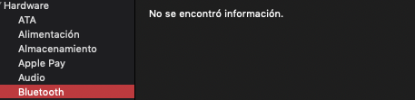

Now the device looks like this
But I still can't get the bluetooth to work or be recognized
As I had already commented on the PTR4 port It is the one that controls the internal bluetooth
I have also disabled the wi-fi card from the bios
Now it tells me as if a Bluetooth device were not present
The USB dongle T919 (BRCM20702 Hub) is connected to the PO14 port
I still can't find How to make it work
It is the only thing that I still do not understand.
How is it that the first time I connected it, it worked and now it doesn't
Already tried to remapping, But I think I don't understand it much or I don't do it the right way
