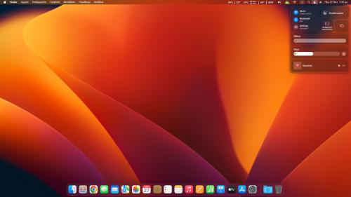

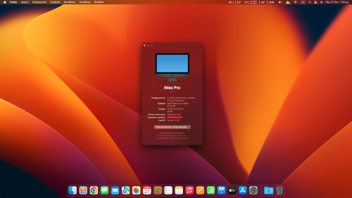

I have successfully updated my system (details in signature and in photos) to Ventura.
First I updated the AMD patches, then Opencore to 0.85, then the Kexts and proceeded crossing my fingers
The only problem I encountered was that the system crashed and rebooted about 10 seconds after getting to the desktop. The culprit was the airportiwlm kext (I have an intel network card). I was using the Monterey version 2.1.0. There is no any available stable ventura airportiwlm kext in "intel open wireless" project yet, so I installed the Alpha version 2.2.0 of it which has Ventura support. Up to now wifi works just fine and I don't get any more crashes/reboots.
Many thanks to all the hard working team in here.
