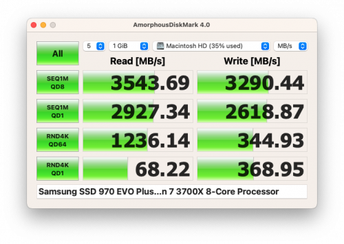

I had similar issue with BlackMagic…. Have you tried AmorphousDiskMark?
