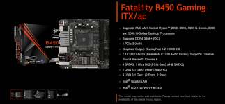

ALCS1220A use layout 15 not working, Sonoma ok, Opencore 10.3 + AppleALC.kext 1.9.4
-v alcid=15 -lilubetaall agdpmod=pikera
