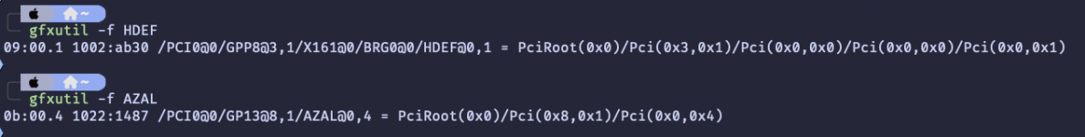

Might be worth mentioning that AZAL appears in my DSDT, but HDEF does not.
As an extra, here's gfxutil's output for both:
My codec is ALC887, which is natively supported, with the following Layout IDs:
I've tried the following, so far: 11, 1, 7, 50.
These were the Layout IDs that people online have been successful with.
Ever since I first made this Hack, back in Monterey-days, I've always used Layout ID 11 - and it has worked flawlessly thus far.
Up until now, I mean.

@Edhawk
Hi, sorry to bother you.
Just thought I'd let you know I made some progress.
I managed to rename my AZAL device to HDEF:
I do still have HDEF under my GPU's node, however.
And still no "Internal Speakers".
Any ideas?
