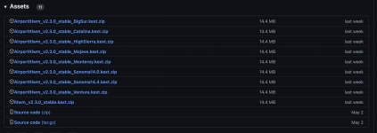

Hi @captincreepy. A couple of things to note in your EFI besides your wifi issue, you are loading Whatevergreen.kext which does nothing in your setup. Best to disable that to avoid confusion. Also USBToolBox/kext is missing from your kext folder and config.plist (you have an entry where it is mentioned but it's not correct) which is needed to activate your UTBMap.kext. Without it there is no USB Port mapping being loaded, you shouldn't need that for WIFI but will for Bluetooth to work. I also I do not believe you need AmdTscSync.kext and should disable it, I see Craig Hazan was using it so that could be a non-issue. I don't need it . Maybe use your USB drive to make these changes so you don't completely bork your setup and once satisfied transfer it to your SSD.
Most users do not use itlwm.kext because it requires heliport. If you disable that and instead load the correct version of Airportitlwm.kext WIFI should work after a reboot and clearing the NVRAM. Make sure to load the correct version that supports whichever macOS flavor you are running or it will not work. Only load one or the other, not Airportitlwm and itlwm kext at the same time. Notice that Sonoma has two different versions you can select from the 2.3 Stable release which is what you want.

Yep, it booted fine but no joy on wifi. I loaded the Ventura 2.3.0 and rebooted as well - no luck.
