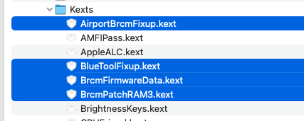

3) Bought a Fenvi T919. After removing the Bluetooth kexts, it seems to work natively with no work (At least for bluetooth). See below for more info.

Despite the Fenvi T919 having native compatibility, it seems apple dropped broadcom support entirely for Sonoma. So while Bluetooth works, wifi doesn't and therefore things like airdop are not working. There seems to be some ways to re-enable the wifi driver, but requires rooting the install, which stops filevault from working. It's also quite fragile and complicated, when it comes to updates.
This really sucks, since I would really like to get this working, but also want disk encryption. Hopefully someone releases a kext or some other workaround one day. If anyone has any info I would really appreciate it. Strangely I occasionally have some continuity features pop up in the dock....
