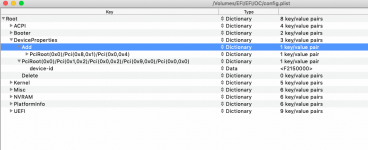

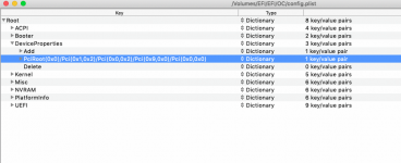

good evening I can't add the device property in add
I don't know if it bothers that it's not in add ?

2,361
Yes it matters if the device address is not within/under the Add heading.
Post a copy of your config.plist and I will add it to the correct section.

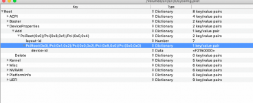

laurent
Oct 30, 2020
80
I think I succeeded
but it doesn't work

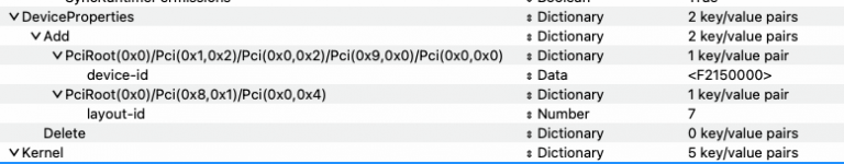

2,361
That image shows the device properties for the network controller within another device's settings. It should look like this:
Screenshot 2023-11-11 at 21.03.25.png viewed in ProperTree plist editor.
The revised config.plist attached below has the correct placement of the device properties.
