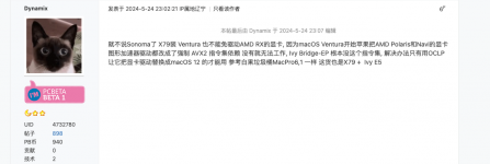

I found that sometimes I switched the proxy and it still didn't work properly until I found this in the forum. It means: Starting from macOS Ventura, Apple changed the graphics accelerator driver of AMD Polaris and Navi graphics cards to force AVX2. There is no instruction set dependency. It won't work. Ivy Bridge-EP doesn't have this instruction set at all. The only solution is to use OCLP to replace the graphics card driver with macOS 12. It can be used as a reference. The same product is X79 + Ivy E5.
Does anyone know how to do this?

Have you checked the OpenCore Ivy bridge EP guide? As your system equivalent is only supported up to Monterey you may have to use more than just the graphics patches in OCLP with your setup to run Ventura or Sonoma.
