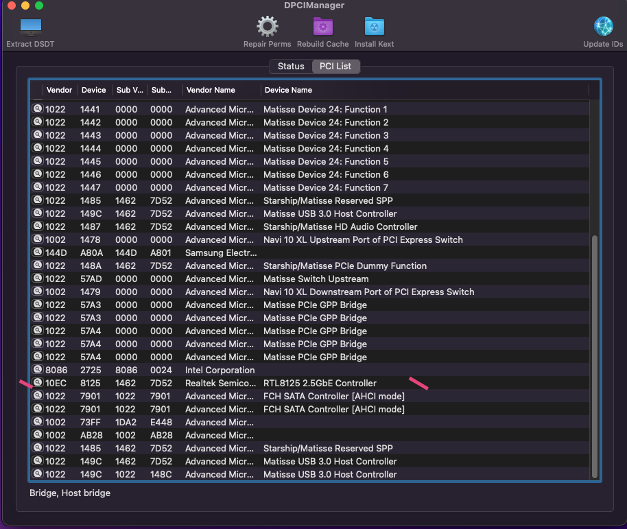

The RealtekRTL8125 Ethernet controller is problematic in macOS Monterey, The LucyRTL8125Ethernet.kext driver stopped working due to some changes Apple made to macOS.
The options available until a fix is provided seem to be these:
  1. Install a compatible Intel PCIe NIC card, in one of the spare PCIe slots.
  2. Use a USB3 to Ethernet adapter.

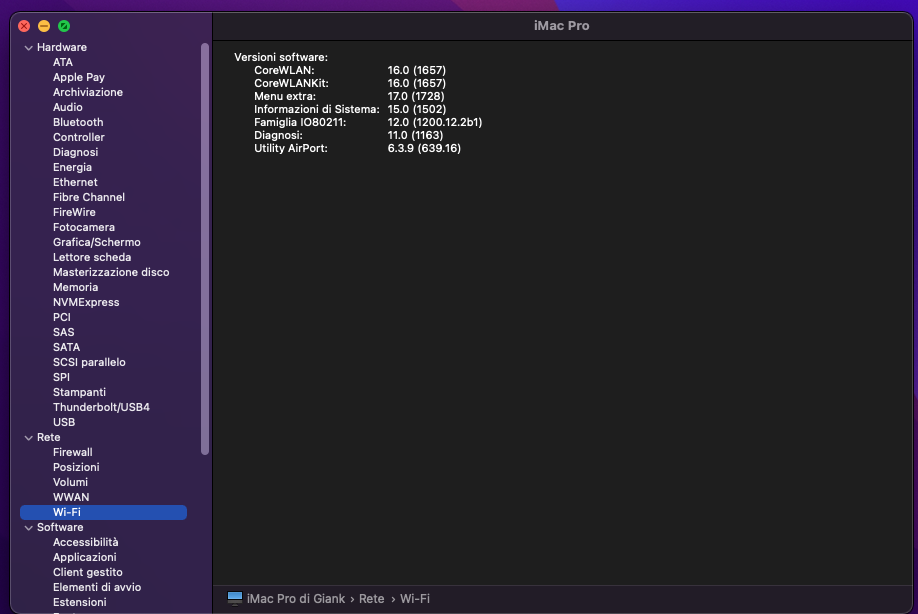

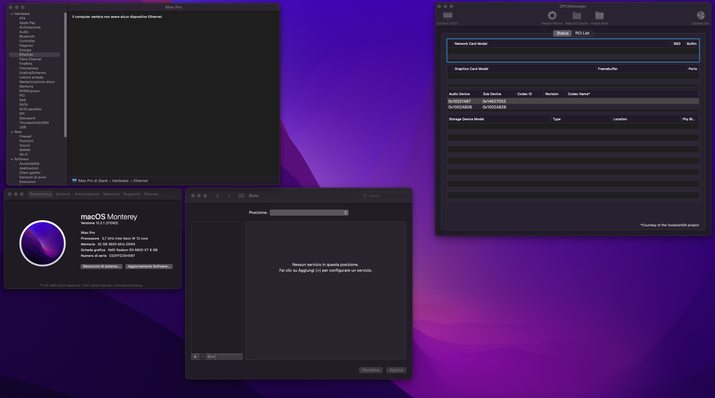

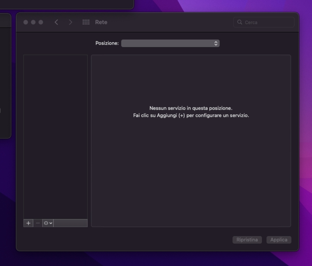

ok thanks, I try to tinker inside opencore, from this image I don't understand if the wifi is seen anyway, but I think not otherwise it had to appear in the network settings.

2,393
No there hasn't been any big change. Hence the empty Network pane.
OP may be using an old bios, which doesn't contain the installation block that effects so many MSI setups.

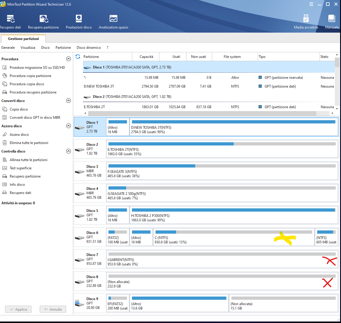

Good evening this time I have another problem, since while waiting for the network card, I configured the machine again, that is only at the software level, and I found that now it does not recognize me two ssd m2 nvme, practically in the first test I was able to install macos Monterey on the ssd m2 samsung 980 pro gen 4.0 inserted in the first slot of the motherboard, now I have mounted the other ssd and hard disk two ssd m2, one from 1T Sabrent and another from 500G Western Black plus I used all 8 sata ports available, I have various hard drives, ssd and two burners. Now it was my intent to install Monterey on SSD M2 Sabrent in the second slot m2, but during the installation phase (Mac disk utility) it does not see both that, nor the other, the Western in the third slot, it sees me only the first, the samsung 980 where now I have installed windows 11. What am I wrong I also tried to format it but does not see it anyway, it may be that I have to disconnect the other ssd m2?
those with the red X do not see them, the rest see everything, the one with the yellow X is the samsung where windows 11 is installed
