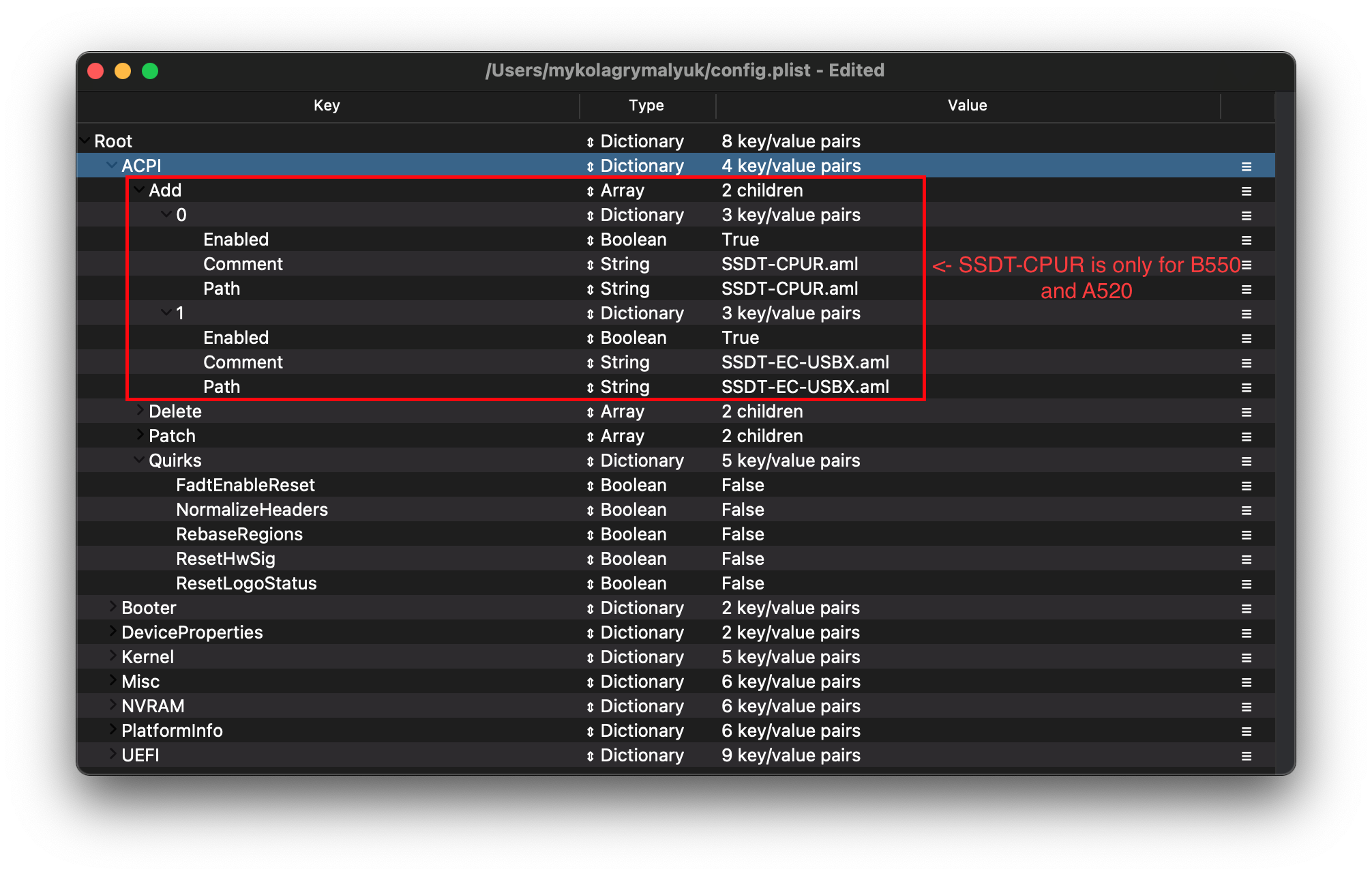

Our GitHub always has the latest available kernel patches. Note you'll need to set core count again, https://github.com/AMD-OSX/AMD_Vanilla
You can get the latest version of kexts from Dortania's build site, https://dortania.github.io/builds/#
If you're having issues upload your EFI and either myself or someone else will help getting it updated.

keef247
Sep 10, 2020
47
Please help this is killing me! I don't get why it works fine on Big Sur but wont even boot the installer on Sonoma?
2,186
Should just be a case of making sure OC, kexts and patches are upto date. You shouldn't need to change anything in the config settings wise.
keef247
Sep 10, 2020
47
They all are? Makes no sense, even OCAT says they are? Why does it work on my current Big Sur install yet won't even boot the installer on Sonoma?
2,186
Upload your EFI and I'll take a look when I can. Feel free to remove SMBios info if you want. Just remember to add it back in when booting.
keef247
Sep 10, 2020
47
Now I'm getting this:
UEFI->Output->InitialMode is illegal (Can only be Auto, Text, or Graphics)!
CheckUefi returns 1 error!
Yet I HAVE added BuiltinGraphics in propertree?
Or can I use OCAT and select UEFI and Output then TextRenderer BuiltinGraphics or SystemGraphics? Baring in mind I'm using a RX570 8GB so no onboard?
Even in OCAT when it validates it and moans about the above, I goto the UEFI and Output and it already says BuiltinGraphics?
This is so frustrating!!!
Can you not make me an EFI and upload it for a 6 core 3600NONX with a b450i motherboard with a RX580 8GB?

Am I meant to have SSDT-EC-Desktop.aml in here
2,186
keef247
Sep 10, 2020
47
This should be set to Auto.
Yes you use that but SSDT-CPUR isn't required for your system.
