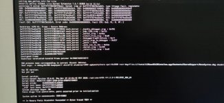

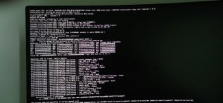

Hi Everyone,
I tried to install Catalina on my PC, on which I installed Monterey successfully before, but due to virtualization, I'd like to install Catalina this time and try VM Fusion 10 on it.
Motherboard: Asus B550M Plus Wifi II
GPU: Asus RX5500XT
CPU: Amd 5700x
SSD: WD SN770
this time I used OC 0.7.8
Thanks a lot for any advice or help.

Try updating the version of Lilu.kext in your OC folder. You are currently using v1.5.7, the latest is v 1.6.1.
If you have updated any of the Lilu plugins such as VirtualSMC, WhateverGreen, NVMeFix etc. to the latest versions they may need the latest version of Lilu.kext to work correctly.
You don't need HfsPlus.efi and OpenHfsPlus.efi in your /OC/Drivers folder. You should not be using two HFS+ drivers, so remove the OpenHfsPlus.efi driver, as the HfsPlus.efi driver is the better of the two.
The AMD Kernel Patches you are using contains 19 patches/children.
  • The latest version of the patches only contains 17 children.
  • Are you sure you are using the correct AMD patches?
  • Have you added two patches for a specific reason?
You need to set the UEFI > APFS > MinDate and MinVersions for Catalina. Using '-1' for both entries is not recommended. You should use the version and date details provided in the guide. Or leave them as '0' when running Big Sur or newer.
Try this revised EFI, which has the latest kexts, AMD Patches, OC GUI and with a cleaned up config.plist.
