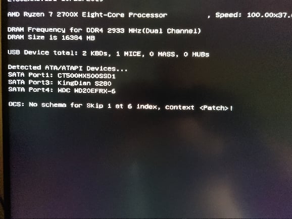

Ocs no schema for skip 1 at 6 index
diniket
Jul 27, 2021
12
This problem slow me boot
Thx

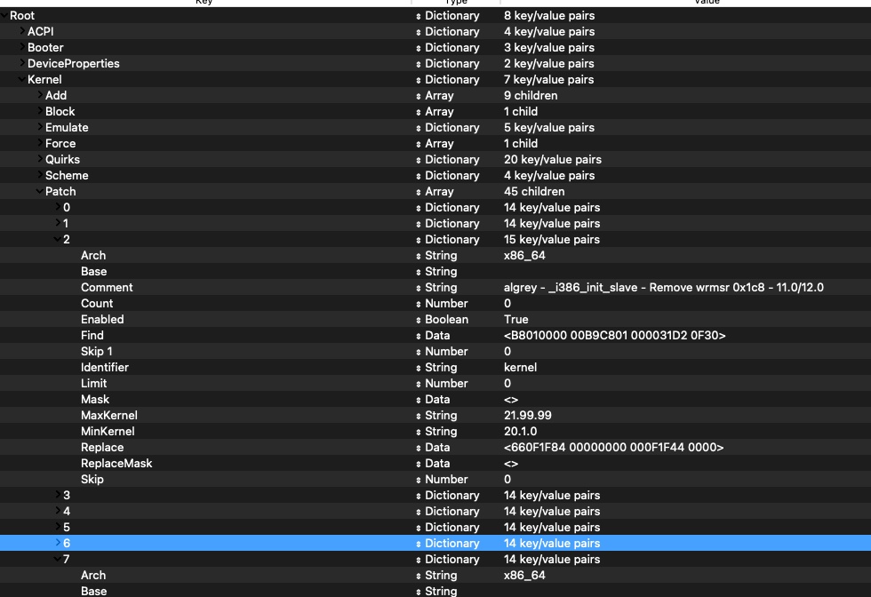

marco@RyzenAMDdiMarco ~ % /Users/marco/Desktop/ocvalidate /Volumes/EFI/EFI/OC/config.plist
OCS: Missing key Skip, context <Patch>!
OCS: No schema for Skip 1 at 6 index, context <Patch>!
Serialisation returns 2 errors!
Completed validating /Volumes/EFI/EFI/OC/config.plist in 2 ms. Found 2 issues requiring attention.
2,177
So either ACPI -> Patch, Booter -> Patch or Kernel -> Patch is missing a Skip entry.
diniket
Jul 27, 2021
12
I added an entry under kernel-> patch-> 2 that was missing
now only an error remains, I checked under ACPI -> Patch, Booter -> Patch but the Skip voices seem to be present

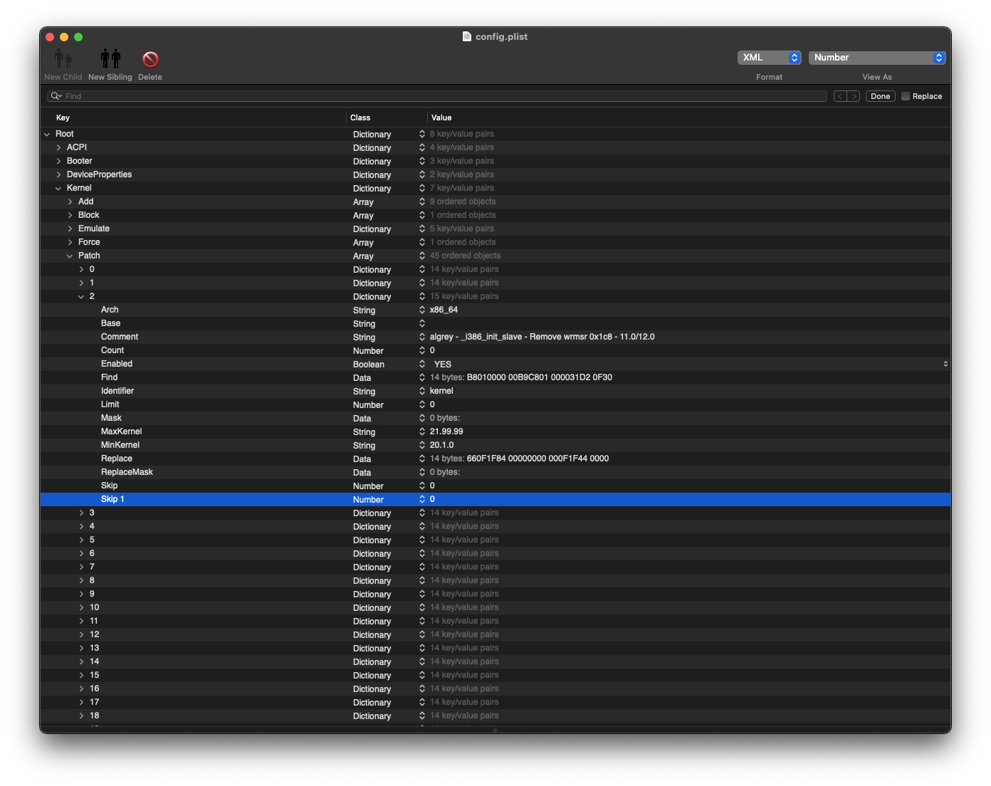

Can you send your config? I'll take a look.
2,177
Here's where the error is. Skip 1 isn't valid. Skip is already there to remove the Skip 1 entry.
diniket
Jul 27, 2021
12
what program do you use to read the config? i use ProperTree, maybe there is a compatibility problem?
diniket
Jul 27, 2021
12
solved thanks, I did not read well, it was more on :)
