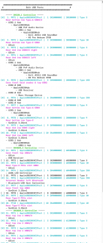

Still no luck with Bluetooth...
Where are the other USB ports, your system has a lot more than 14 x ports. There should be approx. 32 x USB ports shown in your Discovery screenshot.
You do not need to limit the number of ports in your system as would be the case if it were an Intel motherboard. You need to remove any previous USB kexts as they can mess with your new configuration.
Each USB controller in your AMD system, and there are 3 x USB controllers in your system, can activate up to 15 x ports (each controller). You should be discovering and activating every port available.
Just because the Bluetooth port is correct doesn't mean the others are correct!
What is connected to port 2 HS02 - USB audio - Internal or external audio device? If internal then it should be set as 255 not 3.
What is connected to port 8 HS05 - Mystic Light - Internal LED controller? if yes, then this should also be set as 255 not 3.
How is Port 9 HS06 connected? Is this a case front port served from a motherboard header? If yes, which header USB2 or USB3?
