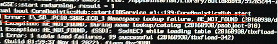

1,269
The boot log shows an error loading the SSDT that creates EC device. System will not boot unless we fix that error.
I’ll check your SSDT soon.

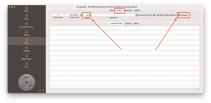

@zgamer109,
Please make the changes shown in screenshot below, then reboot. When the OpenCore boot picker appears, a new SysReport folder should be created in the EFI partition. Please compress (zip) and post that folder.

1,269
@zgamer109,
As suspected, there is no \_SB.PCI0.SBRG.EC0 device in your DSDT. So please replace SSDT-EC-AMD.aml in your EFI/OC/ACPI folder with attached version and reboot. Let's see if this one helps.
