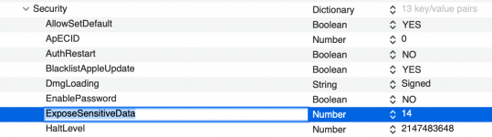

Please set Misc -> Security -> ScanPolicy as 0 . Then you can chose Win10 partition.
Reactions: AMDPUSH
it works ! Thanks ! OC configurator says i am using an old version than 088.

to solve this:
Hackintools shows opencore "ver0.0.0" , so tries to download latest Clover. No worry about it.
you have to use same solution of above post

ok, but i open my config list with Propertree/OC config/ Clover Config, ? because all these tools are up to date and and i don't twant to crash anything.
Plistpro did the trick, and now i see OC 089 !
