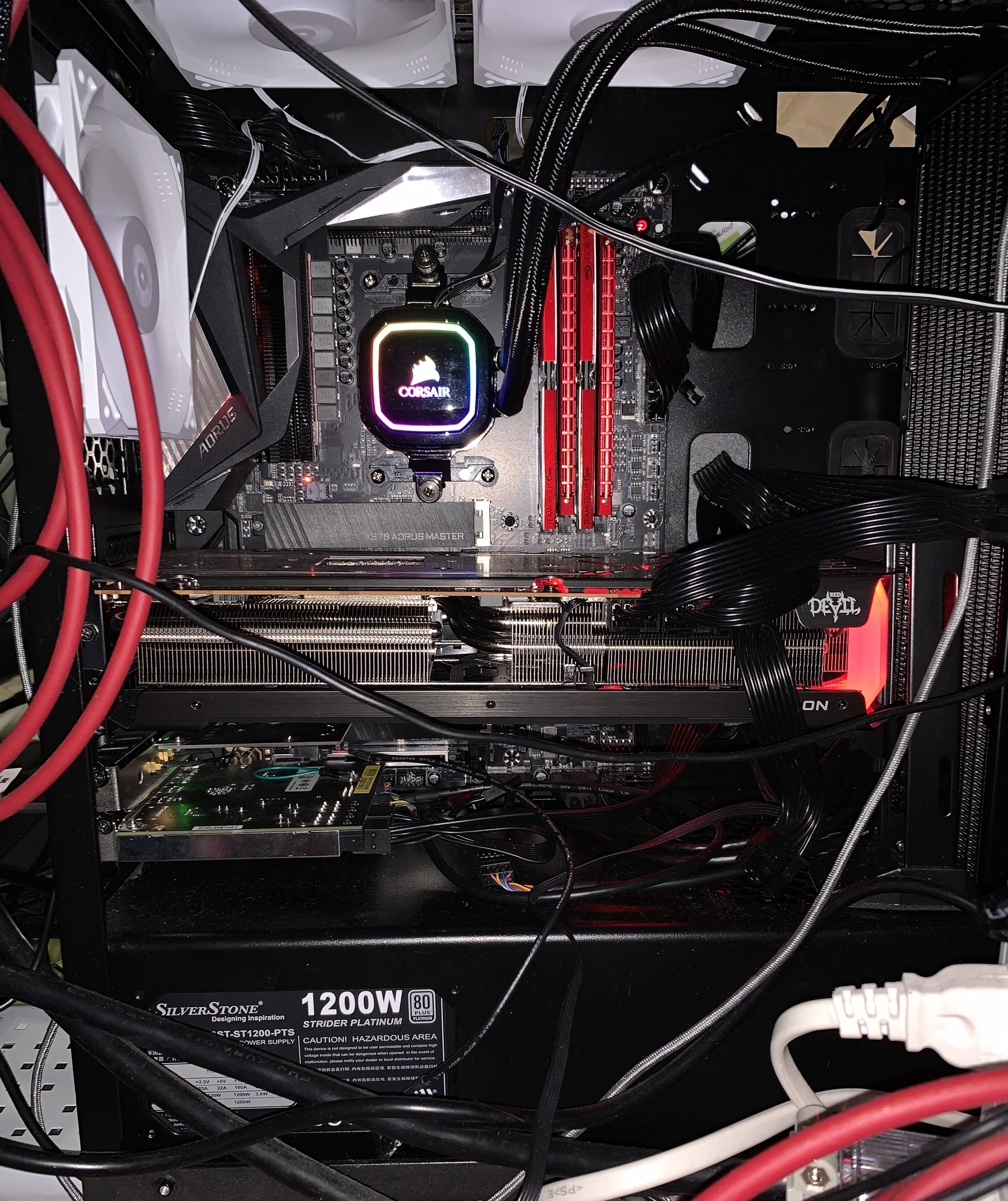

I have reboot after launching on the black screen with the apple and he progress bar. What are your bios settings. Above 4G enable ? for example.
Mymlan
May 3, 2021
24
Yes, Above 4G Decoding is enabled. Because sometimes I use Windows 11. If you. change BIOS settings, then just change Above 4G, I think.

ok..... clover works and.... i don't see anymore my W10 partition... how are doing to use W11 with the canopy ?
AMDPUSH
275
i have 2 boot ssd's and be able too see my W10 on the other one with OC088. but i would like to be able to chose among my disks boot : Ventura/Monterey/ W10.
Anyway thank you, because i didn't need to flash my Titan Ridge v1.2 and it's working nicely with my UA Octo UAD2 TB3 Hot Plug !!!! and no more colorwheel and disabled when loading the plugins

OK..... クローバーは動作し、.... W10 パーティションが表示されなくなりました... キャノピーで W11 を使用するにはどうすればよいですか?
Please set Misc -> Security -> ScanPolicy as 0 . Then you can chose Win10 partition.
AMDPUSH
275
it works ! Thanks ! OC configurator says i am using an old version than 088.

ok, but i open my config list with Propertree/OC config/ Clover Config, ? because all these tools are up to date and and i don't twant to crash anything.
AMDPUSH
275
Plistpro did the trick, and now i see OC 089 !
