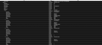

fullfunk
Jun 11, 2021
You need add in config.plist your memory total size calculate from 16gb to bytes then fill the data where the real memory dimms are , then fill the rest with dummy data as in the example of mine.
