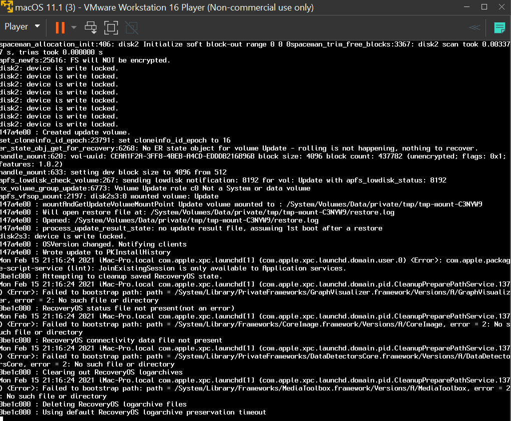

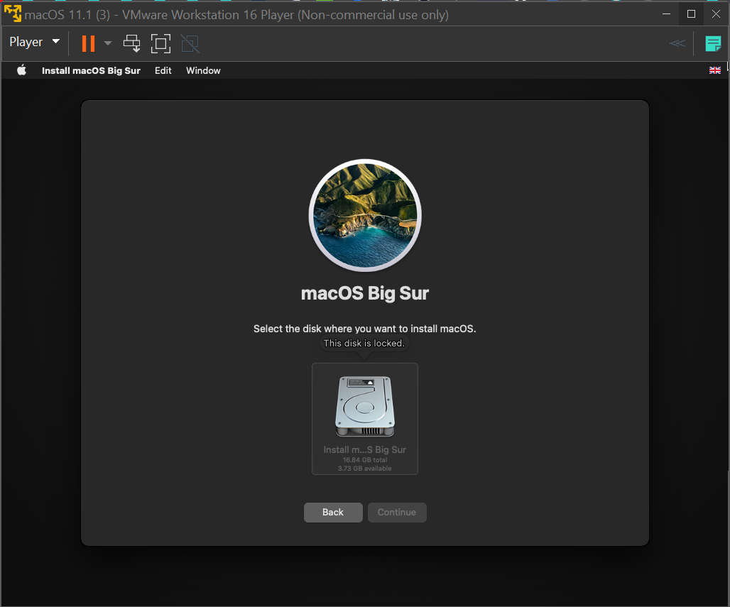

Hey,
I have been trying, and I get stuck installing, in the virtual machine with the disk being locked.
Thanks for any advice,
M
