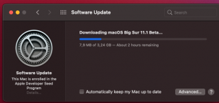

Let see if AMD Kernel patches will survive to this :) :)
