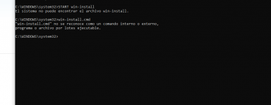

jair117
Mar 26, 2024
lHOLA nesesito su ayuda .
Culdz
Mar 25, 2024
Holla amigo,
When you type "win-install.cmd" the system will execute the file that has this name in the current directory.
BUT given your screenshot, you are positionned into the system32 directory (default windows CMD directory) and the file is most probably not here.
You have to navigate into the appropriate directory where the file is located using the "cd" command and retry the command :
cd 'C:\[PATH_TO_UNLOCKER]'
win-install.cmd
also, I used another unlocker that worked as good and didn't need to type any command, it had an interface, you can find it here, it might better suit your expectations in terms of usability : https://techpp.com/2024/02/12/how-to-run-macos-on-windows-10-11-in-a-virtual-machine/
Search for the "unlocker" part in this tutorial.
cheers

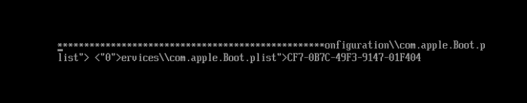

atiqsamtia
Mar 30, 2024
I followed these instructions on a Ryzen 7 2700x in Vmware Workstation 17 Pro
It booted into the setup fine and after a few restarts, it gave me "The CPU has been disabled by the guest OS" error.
I edited vmx file to add AMD related smc and cpuid values.
Then the setup continued again.
But after a few more restart it gives me this error and it stuck here.
Any help?
