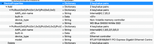

Adding all those DeviceProperties to the config.plist was a bad move. It is more likely to cause things to go wrong than it is to help. I would only retain the NVME and Ethernet DeviceProperties, as those are the most likely to require setting in the config for macOS.
