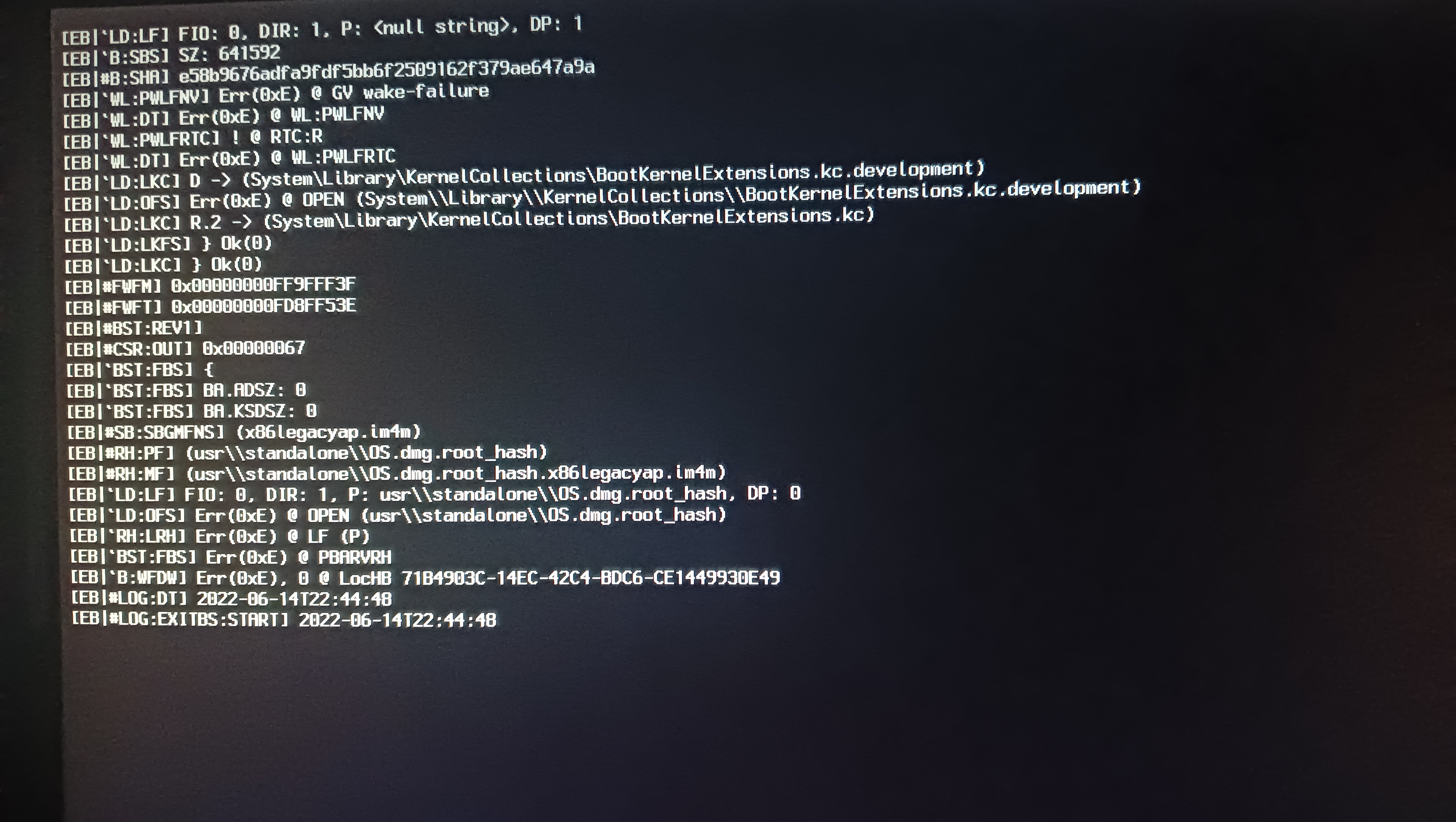

Hi!
I use an open core 0.6.1.
So when trying to install mac os, big sure stops at [Log:Exit is:Start] 2022-06014t21:39:19 and freezes, maybe someone has encountered such a problem?
I'll attach the photos

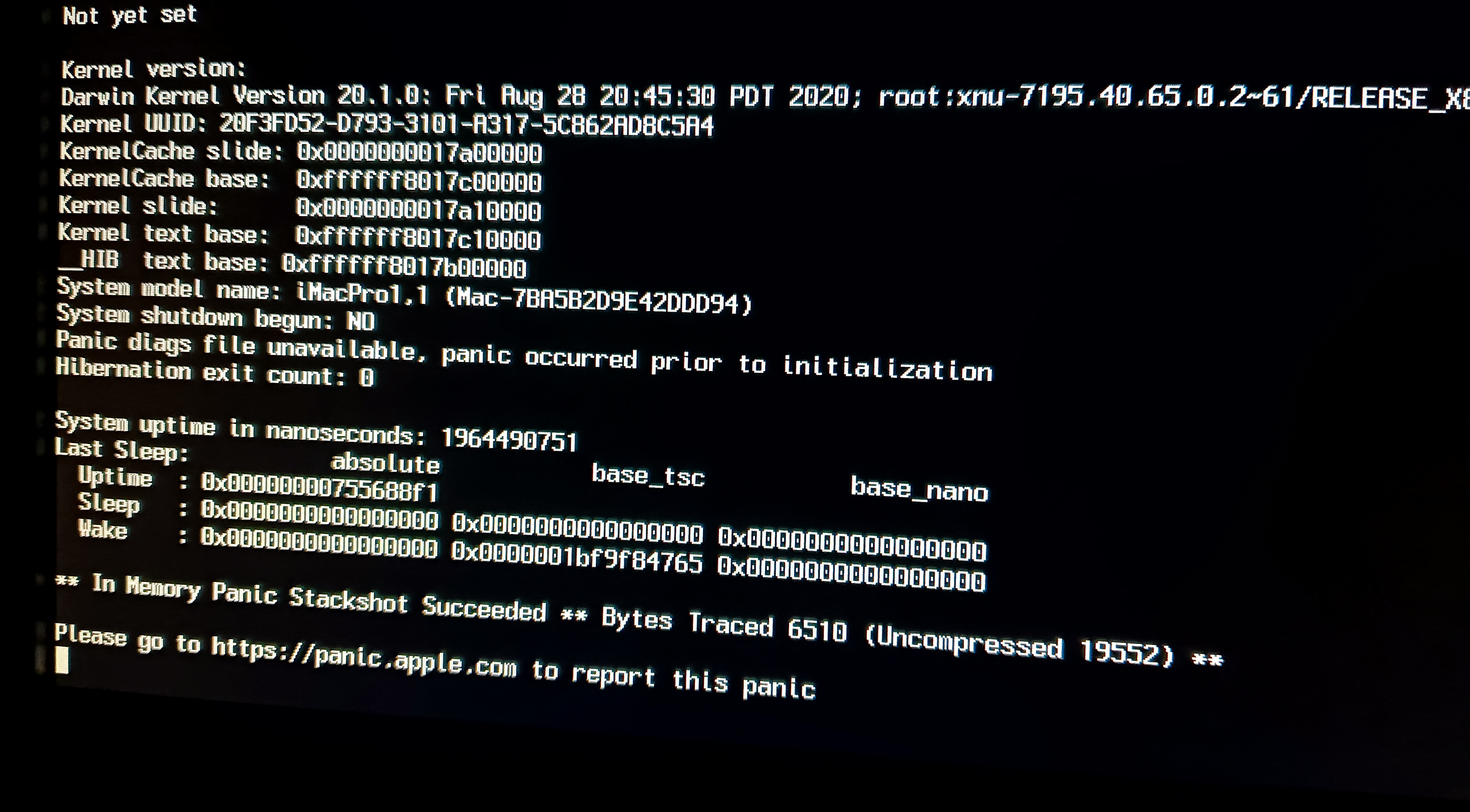

I don't understand anything, the memory panic has remained, what else could be the problem, I don't know

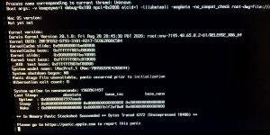

it didn't help
the same result
