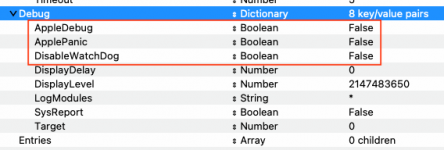

A few items were different to the Dortania guide in the Misc > Debug section of the config.plist.
Screenshot 2022-12-06 at 16.18.31.png AppleDebug, ApplePanic and DisableWatchDog entries are set as false the guide recommends these be set as True.
You also have a number of unused/unnecessary entries that are just placeholders for the config.plist creator, which your Dell laptop doesn't need. Removing these unused entries makes it easier to navigate and read the config.plist.

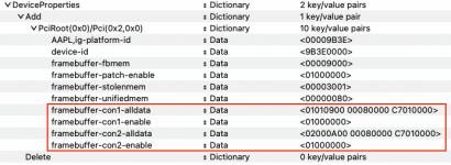

IGPU:
The IGPU Framebuffer in the DeviceProperties section of the config.plist seems to be missing the Con0 entries.
Screenshot 2022-12-06 at 16.16.55.png Framebuffer for IGPU con1 and con2 entries highlighted, missing con0 entry.
You have provided con1 and con2 'AllData' entries (2 x HDMI connectors) but not the main/built-in laptop screen, which I would expect to be set with an LDVS/eDP/DP connector.
Did you take these IGPU framebuffer entries from someone else's config or have you undertaken the framebuffer port discovery process yourself?
Not setting the con0 entries may be part of the reason for the system reboot.

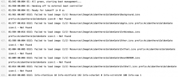

OC GUI error:
There seems to be an issue with the OC GUI icons being found in your setup. This is highlighted in the screenshot from your Pastebin.com OC log.
Screenshot 2022-12-06 at 16.59.56.png screenshot showing GUI errors, related to /EFI/OC/Resources/Image/Acidanthera/GoldenGate icons not being found.

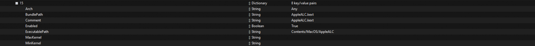

2,376
OK that looks correct.
But that is what is shown in your config.plist, what does your /EFI/OC/Kexts folder show?
Have you updated the AppleALC.kext and by mistake copied the AppleALCU.kext to the Kexts folder? It is easily done.
