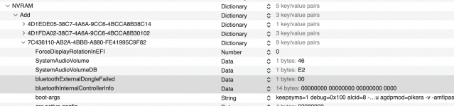

Added the monitor's EDID information in OpenCore using DeviceProperties.
Attached my current config.plist for review.
