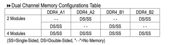

Now I just had one question. It's about the memory modules, the system is always telling me they are configured incorrectly. I have DDR4 A1 and B1 filled. Is there a better configuration for Apple? I will be getting modules for each bay eventually @Middleman @Edhawk
Current EFI is attatched
Your memory configuration is shown in the motherboard manual as one of the options for two memory modules. Although it is not the best.
Gigabyte recommend that you install them in the DDR4_A2 and DDR4_B2 sockets, i.e the first option for two memory modules.
So it should be simple enough to switch the modules to the adjacent slots, for optimised memory settings with two memory modules.

Oh my, I don’t know how I did that. I usually make sure I follow the manual to the letter. I have pulled it apart and put it together a few times. I originally thought Apple might have had a different requirement. I’ll fix this up when I get back home. Thanks
