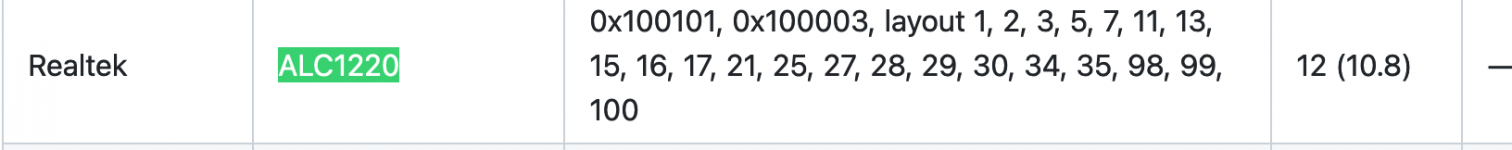

Have updated Lilu.kext and AppleALC.kext to the latest versions?
If yes, you probably need to change the alcid=100 boot argument in your config. As it doesn't seem to be set for your Realtek ALC1220-VB codec.

Thanks @Edhawk ,Lilu and AppleALC are newest, I tried all the id from here, 100 is the last one for testing, but none of them work, I used to use 1 which works in monterey.
