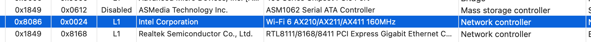

Hi guys, I am currently using Opencore 0.7.0 and I wish to work on my bluetooth.
I bought an Intel AX210 WiFi + Bluetooth (Fenvi AXE3000).
1. There is no information in my bluetooth
2. I tried mapped all the USB but I only found USB ports for USB controller. I removed extra USB and set XhciPortLimit to false. However, I cannot find any internal USB (that suspect to be bluetooth) neither in Hackintool or IORegistryExplorer. Thus, I haven map my Bluetooth as 255 yet.

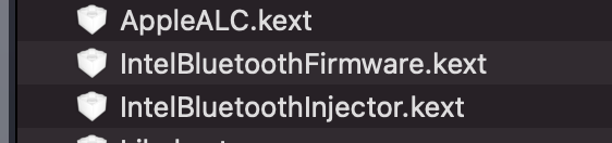

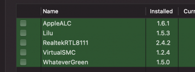

3. I installed both IntelBluetooth kext but Hackintool doesn't show that the Kexts were being loaded.

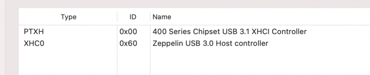

Also a B450 Motherboard has two USB controllers so port limits shouldn’t be an issue. It’s 15 ports per controller not per system. 👍
Did you also add the kexts to your config? Also injector only kexts don't show as loaded.

Maybe I understand it wrongly, oh I see its 15 per controller, the weird part i found is my Hackintool show two USB controller but in motherboard one is plugged with USB and one is plugged with my Bluetooth.
yes yes, I added them to config.plist.
Hmm thanks for telling that injector kext shouldnt be showing here. 🙏

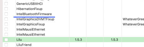

But the IntelBluetoothFirmware also not showing as installed ><.
The Lilu seen as highlighted here meant installed if I am not mistaken
I think for Boolean you use True(Yes) or False(No).
Enable Boolean = True
