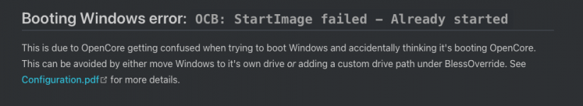

sometimes i have :
OB: StartImage Failed
I'm so HAPPY !
Thank you :) It's work great for first time ;)
2,381
OB: StartImage Failed is caused by OpenCore getting confused about what actually is booting, Windows or OpenCore.
See this extract from Dortania Troubleshooting guide.
You would be best served removing any drives other than the USB installer and the macOS drive, while installing macOS and troubleshooting any issues. As it prevents these types of issues occurring.
