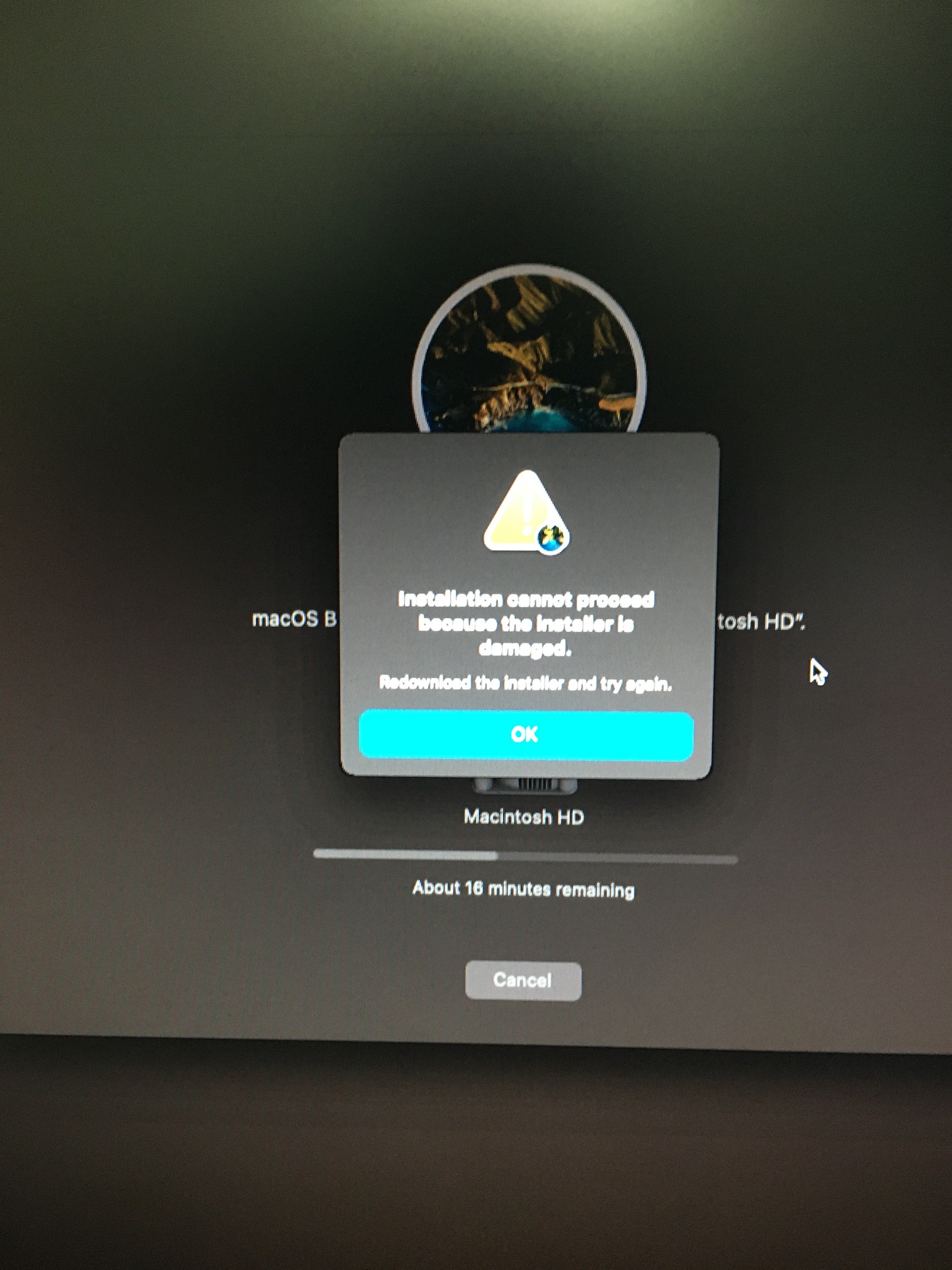

Ok the build is finish and I'm stuck at this:
@Shaneee
I used @AudioGod's X570 Aorus Pro EFI and it got me into the installer but the installer crashes half way through :(

My EFI will work just fine with your X570 Elite just make sure you disable the USBMap.kext and remove agdpmod=pikera from the boot arguments and thats about it. You can also use the Bios Settings laid out on my thread.
That halt isn’t related to the EFI though bud, unless agdpmod=pikera is effecting it (doubt it). Maybe try recreating the installer.

Hi @AudioGod thanks for the reply and for your detailed topics on X570 rigs.
Yeah that's what I though and I already tired with a new Installer but the issue was the same, I already disabled the USBMap.kext and it suck at the same point and the agdpmod=pikera shouldn't cause the issue I might need to downgrade the BIOS though because I think I read somewhere (which I don't remember where) that someone had some issue with the installation so they did downgrade the BIOS and managed to resolve the issue but that might not be the case for me.

@Cyberdevs Bit of a long shot but try removing the boot argument npci=0x2000 and then go into the bios and enable Above 4G and see if that helps.
Some Polaris GPU’s do not like that boot argument at all but again it’s a long shot as the error doesn’t fit the crime.
Latest bios revision for your MotherBoard is F33h and that uses AGESA 1.2.0.2, That should be fine. I’ve heard the latest ASRock bios revision can be a bit of a trouble maker but I’ve not come across a gigabyte X570 using AGESA 1.2.0.2 that has any troubles like that.

@AudioGod
Thanks for your input bud but I found the issue, I removed two of the memory modules and was able to instal Catalina and I'm trying to install Big Sur as we speak with my fingers crossed :D

Nice one but that’s also strange. Why would using 4 sticks of memory be an Issue?
Have you tested the ram for errors by any chance?
Might be worth investigating that one bud.

Well the problem must be because I had two Kingston HyperX Predator 8GB modules (which I had tested before and I was just able to install Catalina and Big Sur successfully using them) so I bought another two modules with the same frequency but they are HyperX Fury so either there are incompatible with each other (which they shouldn't be) or those new modules are problematic, so I will swap them tomorrow and try to clean install macOS with the Fury ones and see what happens.
Yeah that would make sense as if just one sub timing differs it can chuck the whole thing off kilter. I use A set of Hyper X Fury RGBs myself. I was using some Corsair Vengeance Pros until a few weeks ago but discovered that every now and again they would cause my MotherBoard to throw a wobbly and I would have to short and clear my cmos to bring it back to life. That’s what happens when you try and carry across old Intel optimised ram onto a Ryzen system. Them AMD CPUs can be well touchy when it comes to memory can’t they The cheeky buggers? 😂

So I couldn't wait until tomorrow so I swapped the RAM modules and now the installation completed the phase one with the Fury modules hahaha!

The funny thing is that I just added all four modules and Big Sur is just started the second installation phase so my assumption is that the memory modules must have not been seated properly or something else might have been going on. Once the macOS is installed I will stress test the memory just to make sue they are OK.

The problem is If the timings of two sets of modules are different then it’s going to change one set to match the other and thats where instability’s would come into play because the settings it changes one set of modules too might not be stable. I would never recommend mix and matching unless every single timing lines up.

Yeah I know that and I checked the timings before purchasing the new ones otherwise I wouldn't have bought them but I totally agree with you on not mixing different types of memory modules but to be honest I couldn't find HyperX Predator modules so I had to gamble with the next best thing lol.
But if the stability becomes the issue I will definitely match all four modules.

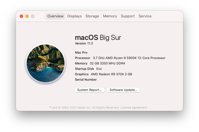

et voilà!
Finally! Just need to swap the GPUs from my Skylake Rig to the new Rig :D

Nice work. I’d say welcome to the dark side but… light mode lol
