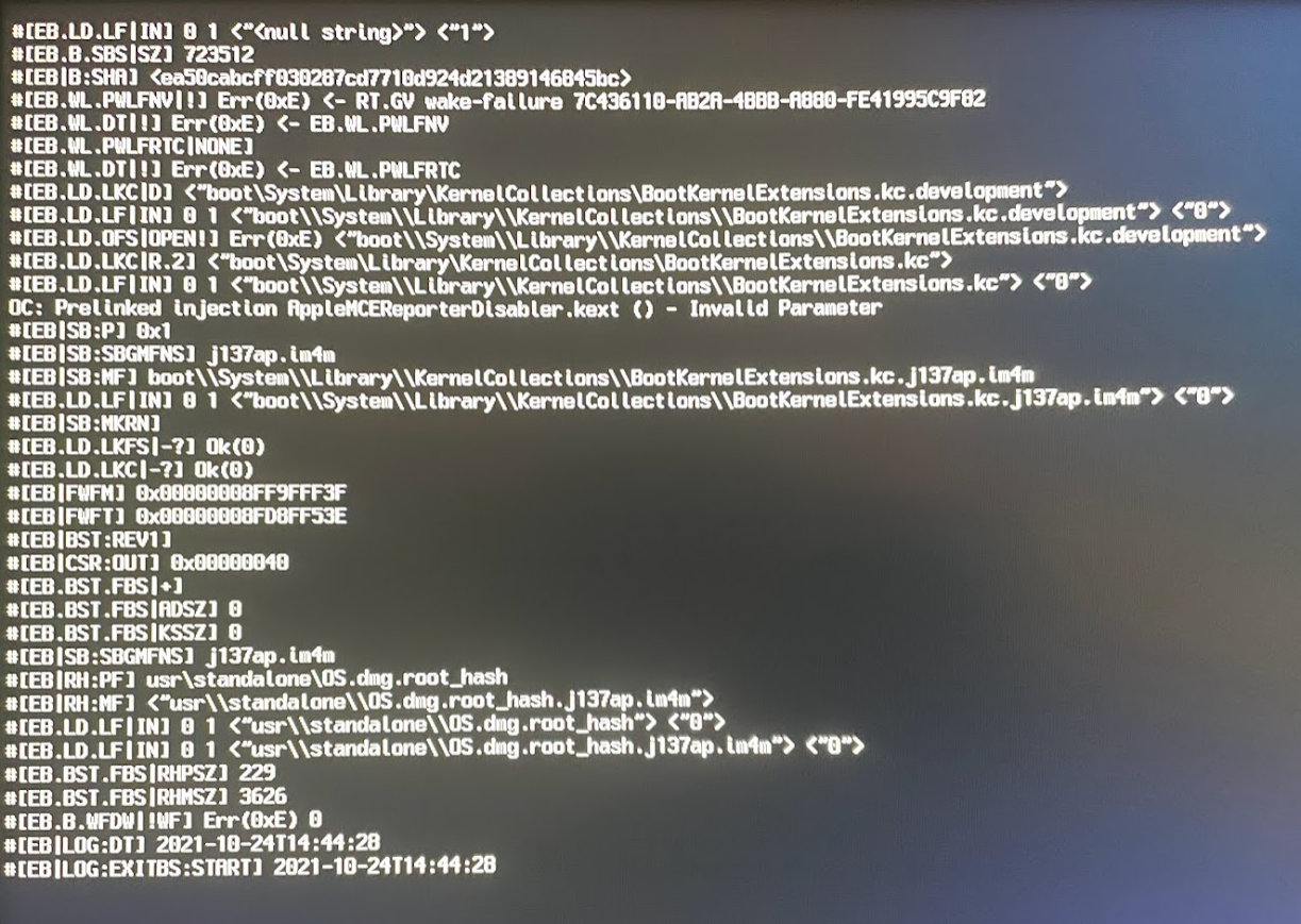

I tried to update from BigSur 11.1 to 11.6 but the system hangs on reboot to upgrade.
At this point, I tried to install OC 0.7.4, but even in this way, the Update operation did not give a positive result.
I attach my EFI-OC.6.3 directory which contains all the working drivers for my computer.
Thank you to give me a hand.
Best regards!
Here you go. Updated to 0.7.4 and acidanthera kexts updated. Test it on a USB device first just to check.
First of all, thanks for your reply! I saved the EFI in the USB and started it. Unfortunately, the startup didn't start!
I tried with the MACOS upgrade partition
I tried with MACOS 11.1 (the partition that booted smoothly with the old EFI).
I didn't see any differences from the 2 partitions!
Below you find the verbose-boot screen attached, I hope this helps you to show me a solution.
An error also appears when starting the OC menu from USB:
OCS: No schema for ResizeAppleGpuBars at 16 index, context <Quirks>!
Serialisation returns 1 error!
Best regards

Solved the problem.
I'm restart from 0 with the config.plist.
I used it as a base the configuration found at this link: https://forum.amd-osx.com/index.php...ig-sur-monterey-beta-opencore-0-7-4-efi.1344/
I just updated some driver / kext and modify the number of the core in the config.plist kernel/patch (my CPU is 8 core) and finally all is started (we have only a problem with the wifi....).
