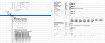

I’m attaching my EFI file where I’m attempting to spoof the video card. Could you please take a look and see if anything is missing?
Could you please correct me if I'm wrong? According to the link you shared, spoofing isn't correct. Please refer to the attached screenshot for clarification. The file sys_info.png shows "metal supported," but ioReg.png indicates that spoofing is not accurate.

It will only look like that if your RX 6900 XT has a correctly configured SSDT-BRG0.aml table in you OC setup.
See if this helps with anything
