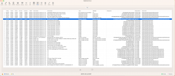

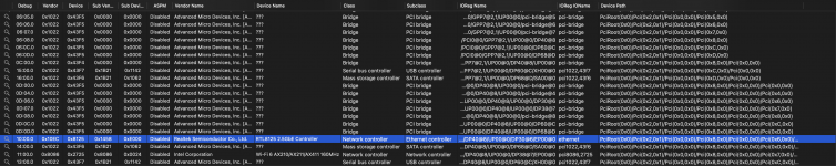

I'm becoming crazy to have the integrated LAN card Realtek 2.5GbE working. The chipset is RTL8125, I see it in the entries in PCIe tab of hackintool,
I'm injecting the kext and is loaded but ... no joy.
I have the kext added
I have the same MB: Gigabyte Aorus X670 Elite AX. Processor: ryzen 7 7700x
I've been trying for over a week with no results.

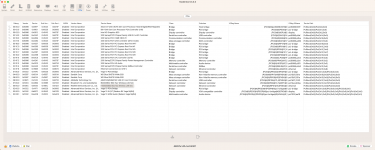

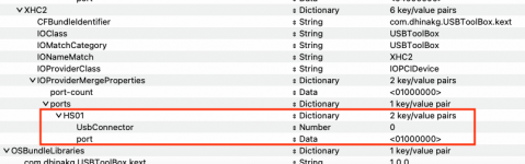

@elferras seems you have not patch any USB port and you need to patch ACPI specifically for your system with SSDTTime.
