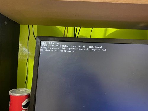

I've been trying to install big sur through opencore for a while, so far without success! I managed to get the menu to appear once but the keyboard didn't work. I managed to get High Sierra but it is too outdated for the function I want to use (xcode and flutter). Here's my Config.plist and my specs.
My bios is legacy, but when I perform the procedure through bootice, it gives this error just below.
If anyone has a similar specification and wants to make the EFI available I would be grateful.

How did you create this EFI? Looks like your OpenRuntime version is lower than your OC version. Also, you didn't clean out your Drivers folder. I suggest you to follow the Dortania guide and pay attention.
To set the EFI for Lgacy booting you need to use the Legacy-boot script in the OC Utilities folder. This script can be found in each release of OC. This script will create a Boot file, which your system will use to boot OC.
The script will ask you to select your boot drive and place the Boot file alongside the EFI folder.

I'm using your EFI-0.81 (with some adjustments), i found it in your posts. I create the boot file by following the Dortana Guide (with bootice x64) and using a proper OpenCore release (0.81). I get BOOT MISMATCH again with this setup.
