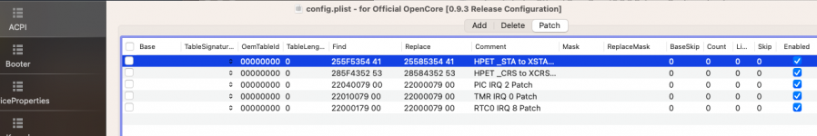

@Jumper981,
Okay. I've looked at your EFI and from your specs I see three potential issues:
1) It seems you have unnecessary ACPI patches compared to other 7950 builds?
Were these generated by SSDTTime or not? If not please remove them, they may be conflicting and causing KPs.

1) yes probably I don’t need to correct IRQ Conflicts and HPET as I read that is not found on newer macs, thought those were generated by SSDTTime.
