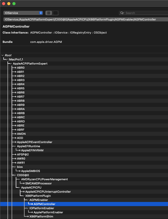

Thank you all! SSDT-PLUG did the job! :D

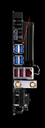

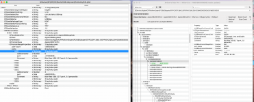

Lets take this port for example:
When I connect an USB2.0 to this port, it appears in this address :
Then, I plug an USB3.0 stick to the same port:
So, where's my mistake? I should name all ports "3", even if it addresses to usb2.0 port?
(Dortania's guide says, that its 2 addresses for USB3.0 port.. one for 2.0 and the second one is for 3.0 and above..)

What colour is the port?
if it’s blue it’s not usb2.
You list the port your using not the usb type your sending down it.
Make sense?
