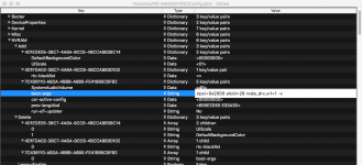

To boot Big Sur you'll likely need SSDT-CPUR & SSDT-EC-USBX-DESKTOP.aml in ACPI, OC 0.6.9, Lilu, Whatevergreen, AppleALC, VirtualSMC, USBPorts.kext and SMBIOS iMacPro1,1. No need for boot-args other than alcid for your soundcard.

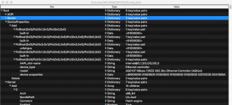

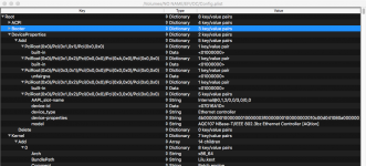

I was able to get the right PciRoot tree with into my config.plist
After i updated the PCI Root path all the changes show up in IORegisterExplorer to Aquantia,
---but did not work with device ID you gave and when I use it the Device Name would not show up in Hacktool so I just left it out now seeing if that works but still no luck
If you have another address to try for device ID, I can try it.

yes, I used it in Device ID but it did not work and caused Device name to go blank in Hacktool so I tried to boot without Device ID in config.plist, but still did not work
However without the Device ID in config.plist the Device Name was no longer blank and showed correctly. So left it like this for now.
I can try any other Device ID you think might work.

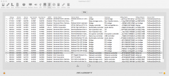

Okay how about this. Run Opencore Configurator, but use the version that fits your current version of OC (as later versions do not mix well with earlier versions of OC config plists). Go to the Device Properties, delete your current Aquantia settings list on the far right and then using the List PCI Devices selector, select Add Device and try and add the Aquantia card property back in. It might populate it with the correct info.

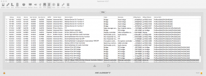

No luck with this method, although when Opencore Configurator added PCI device it did not add a Device_Id

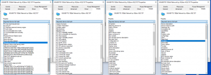

Almost forgot the most obvious solution...check your Windows Device Manager settings and see what comes up for the hardware device id. Whatever that comes up you need to put it in reverse byte order in the EFI as device-id.
There are a lot of properties in windows 10 Device Property list for the Aquantia 10Gig Ethernet.
The closest I can find is "Reported device Ids hash" below. (does this mean I should try device_id = "EEB4F344" ?)
Below is the full Property list,
let me know if you see one that should have the correct device_Id and i can post value to see if it makes sense to try
Also looking through the list and their values,
below property looks like it may be ID we are looking for but the Property name is strange so not sure what to make of it.
You just need Hardware IDs. It will tell you the device and vendor ids. You will need the device-id, and place it in reverse-byte-order.
Hardware ID's below:
I just realised - rechecking the posts, the line with the long value I posted in my initial posts was actually for key 'device-properties' not 'device-id'.
That may be where you went wrong.
So you'll need to redo the lines like this:
key: device-properties
value: 4b00000001000000010000003f0000000100000002010c00d041080a0000000001010600041c0101060000007fff0400160000006200750069006c0074002d0069006e0000000500000001
type: STRING
type: STRING

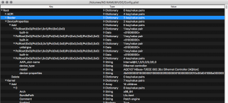

didn't work:
Maybe try to boot yours in windows and look for what device property this address is under and let me know so I can pull it from windows and swap it. so it would be correct one for my board.
Also tried it as data instead of string, just in case it need to be, still no luck

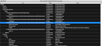

Okay. With the device-properties in place using STRING type, try to add another line in like this:
key: device-id
value: 07D16A1D
type: DATA
but instead, once filled in move this line to just after AAPL,slot-name, and move the model name line to the bottom of the list. Load order of the keys is important.
key: device-id
value: 07D16A1D
type: DATA
did not work and hacktool still looses Device Name when inserting devie-id
