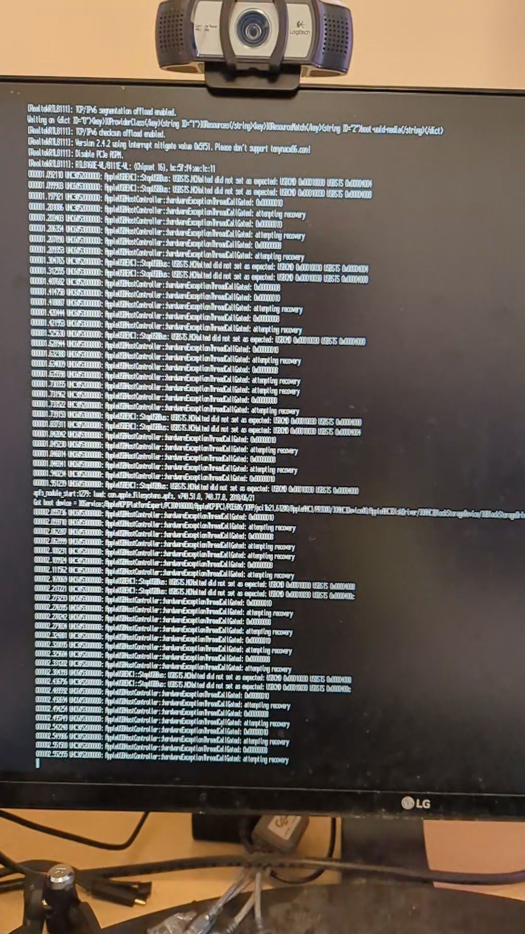

I tried disable XLNCUSBFix.kext, both with and without GenericUSBXHCI.kext, it doesn't work.
Once XLNCUSBFix.kext is remove. I saw tons of "HCHalted did not set as expected:" error (see attached screenshot).
Since this is USB2.0 (black port), I think it is related to AppleUSBEHCI, not XHCI anyway, right?
I also remembered in 10.12, I need to use Shaneee_Sierra_USB_Fix.zip, is there something similar for 10.13?
Thanks.
2,171
With my old FX rig, everything on High Sierra "just worked". I only used the GenericUSBXHCI kext and 2.0 ports work natively. If you've got a 3.0 port on the board use that for the installer and see if it'll boot that. If it does then great. Use Windows to create a USBMap and add it to your EFI. https://github.com/USBToolBox/tool
