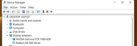

dungnguyen
Sep 9, 2021
this my pc: nvidia Slot 1, AMD slot 2
In Mac os : disable Nividia card ( open Opencore config add devide pci disable nvidia card)
In Windows : disable AMD card ( disable in devide manager)
