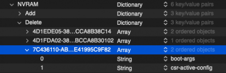

I had to add csr-active-config to Delete as shown here.
895
Either add it to Delete, or do an NVRAM reset before booting up with the new entry. OC won't override existing NVRAM keys otherwise.
i always do an NVRAM reset, i did after add it to Delete but no success.
