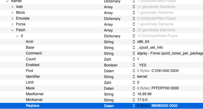

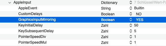

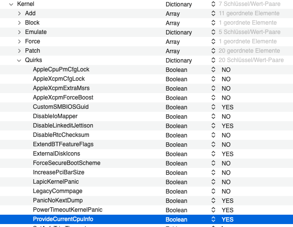

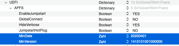

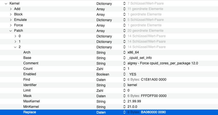

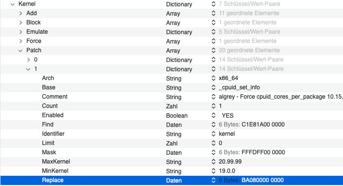

Hi,
here now my new EFI, there are some changes, for example the kernel patches from Shaneee.
What exactly changes you can find here.
Otherwise only small adjustments that occur with every OC update.
Have fun.
If questions, then questions !;)
