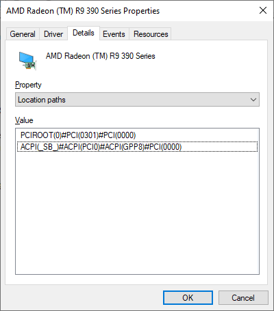

I've tried to use the Dortania guide to spoof the Device ID to an R9 390x as described but it doesnt seem to be working
When I use this path the PCI GPP bridge gets changed not the r9 390 as the bridge is PCI0/GPP8
where as i read the GPU as PCI0/GPP8/GFX0

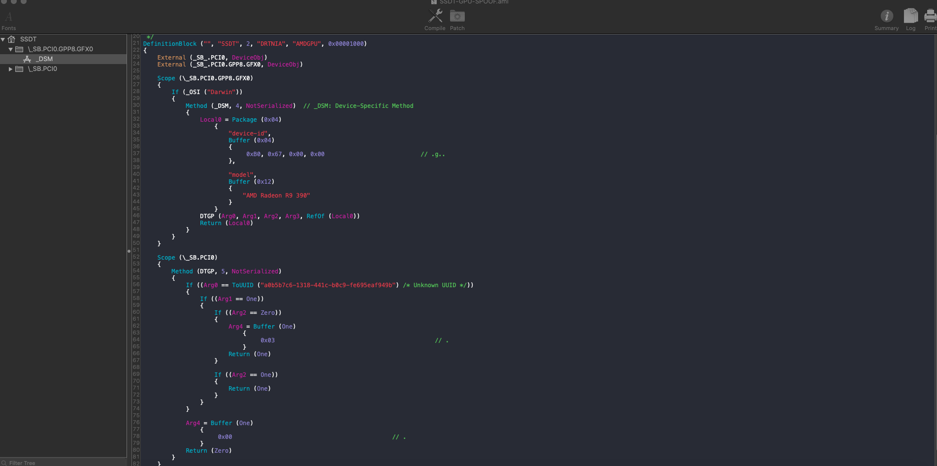

I use this GPU_SPOOF
but still no luck

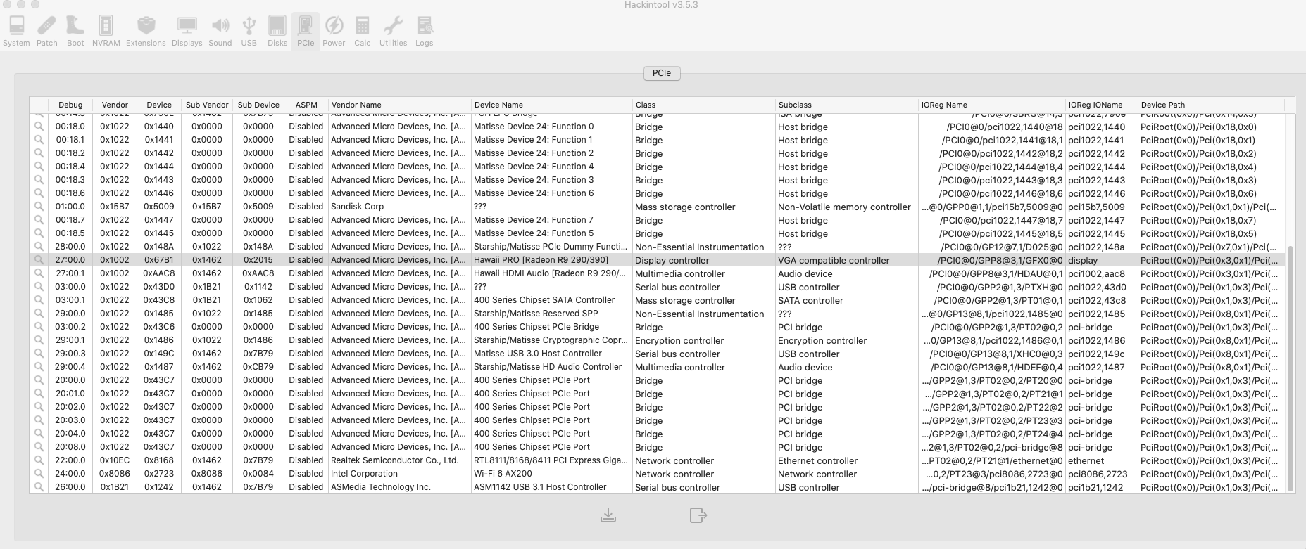

In the Hackintool PCI list right click your GPU and select "Copy Device Path" and paste it here.
Should be something like this,
PciRoot(0x0)/Pci(0x3,0x1)/Pci(0x0,0x0)
bbutlerau
Mar 13, 2021
9
Hi Shaneee
here you go:

Ok remove the SSDT you are using to try and fake the device ID and add this into your config.plist file.
  • spoof.plist

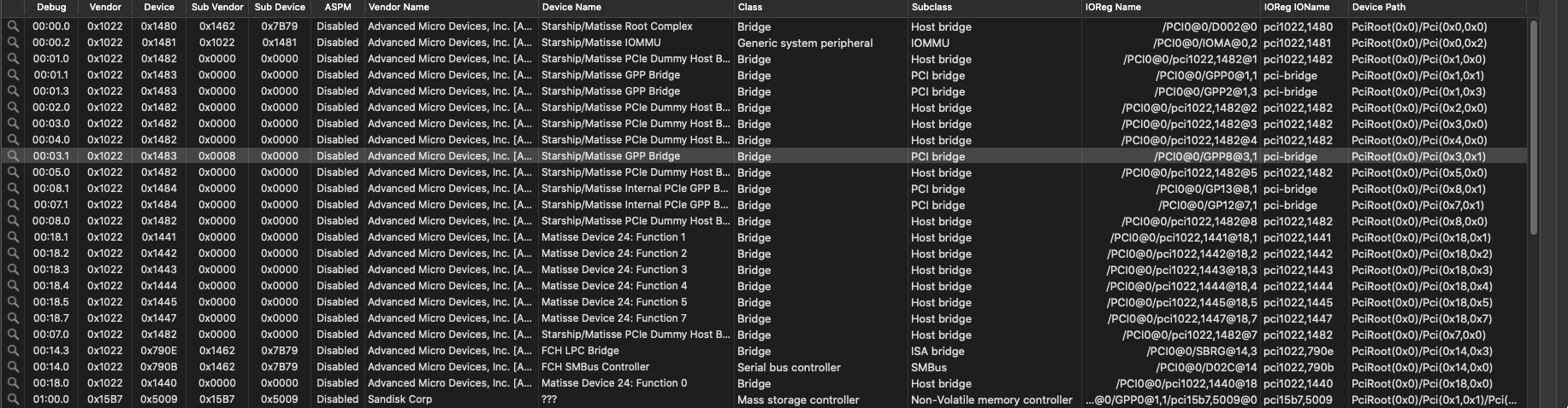

Update though, in hackintosh the IOreg name is now PCI0@0/GPP8@3,1/display@0 rather than PCI0@0/GPP8@3,1/GFX0@0
bbutlerau
Mar 13, 2021
9
Success!!!
I found this forum:
Here
I added a SSDT to add the GFX0
then Shanees plist edit worked!

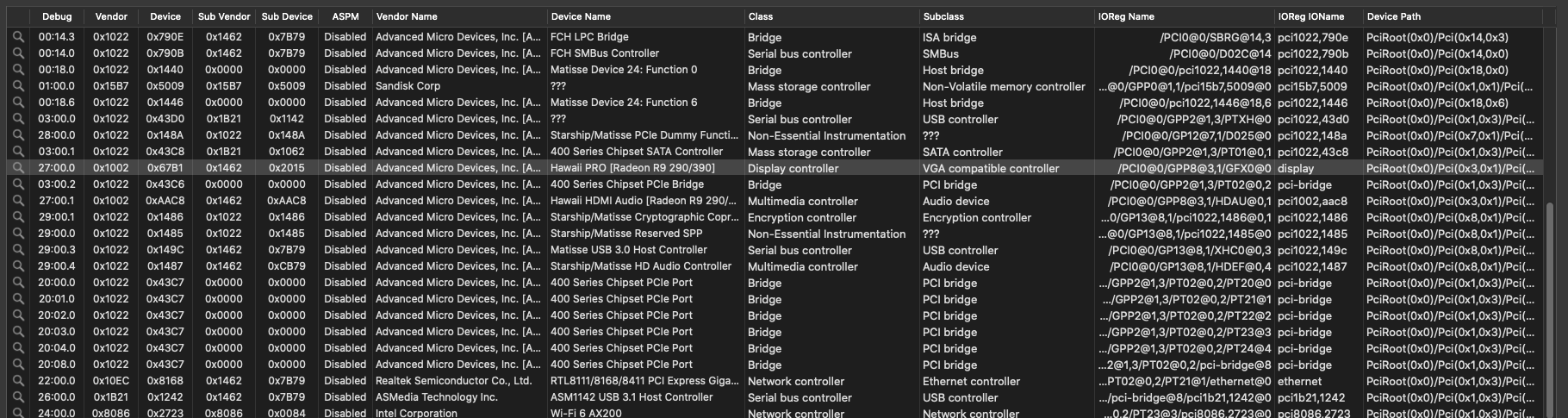

Hello, thank you very much for your help, I don't have much knowledge about hackintosh, I wanted to continue using the catalina, I can disable SIP to install the kext in S / L / E, but I intend to do that when I really managed to change the ID. see, the path of my video card is SB.PCI0.PC03 correct? When I make an SSDT-GPU-SPOOF.aml file and load it in config.plist the system starts normally, however when I open hackintools, oddly enough, a new device appears with the ID I modified, but it is not the device of the display. the video device is still 665f with the path SB.PCI0.PC03_GFX0. when i saw this, i modified my SSDT-GPU-SPOOF.aml to this new path, but without success. the device that had the ID 665C is gone. follow the prints and my EFI. Sorry for my English, because my native language is Portuguese. I am using a translator
EFI, prints, IOREG
EFI, prints, IOREG
I see. If the new device appeared then that means the first patch worked! You're supposed to leave it alone. The whole idea is for the 665C to appear - because that's what is on the Apple AMD macOS drivers. You're going to have to recheck your Windows ACPI path to correct that one.
