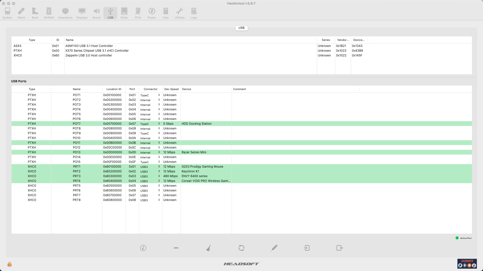

I'm back home and here's what the USB tab in the Hackintool looks like, let me know what you think.

Your USB setup is wrong. I don’t see the Bluetooth device, so can only assume they motherboard header port it is connected through is not active in macOS.
  1. You have the USB2 ports set with the ‘Internal’ connector type,
  2. They should be set as USB3, if served from a physical USB3 port,
  3. They should set as USB2 if served from a physical USB2 port.
  4. They should only be set as ‘Internal’ if they are served from a USB2 motherboard header port.
Your motherboard has the following USB ports:
AMD Ryzen™ 2nd Generation/ Ryzen™ with Radeon™ Vega Graphics/ Athlon™ with Radeon™ Vega Graphics/ Ryzen™ 1st Generation/ 7th Generation A-Series/ Athlon™ X4 Processors :
4 x USB 3.1 Gen 1 port(s) (4 at back panel, blue, Type-A)
AMD X370 chipset :
1 x USB 3.1 Gen 2 front panel connector port(s)
AMD X370 chipset :
4 x USB 3.0 port(s) (2 at back panel, blue, Type-A + USB Type-CTM, 2 at mid-board)
AMD X370 chipset :
4 x USB 2.0 port(s) (4 at mid-board)
ASMedia® USB 3.1 Gen 2 controller :
2 x USB 3.1 port(s) (2 at back panel, teal blue, Type-A)
So you should have a maximum of 4 x Internal USB2 ports In your setup. All the rest should be set as USB3 or Type-c.
You need to scrap your current USB setup and undertake the USB port discovery again, paying attention to the info provided above.
