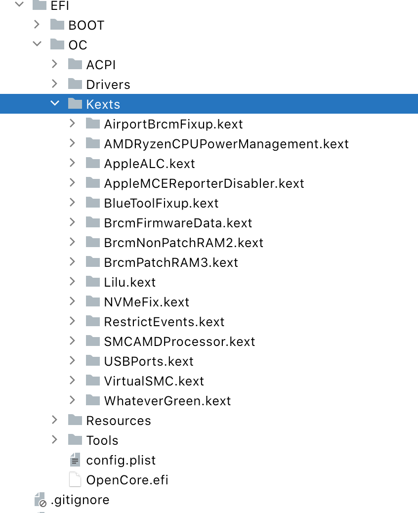

I can't seem to get my Bluetooth working. Based on the guide, I have Broadcom kexts, as I'm using that rather than onboard. With Intel kexts, I had stability issues.
Wifi works, so I am hoping BT also works, unless I got a dud.
My EFI is available at https://github.com/mnrasul/hackintosh-config/releases/tag/monterey-installs-2
My kexts are as follows.

Remove all those kexts you've added for the card. I also use a BCM94360CS2 and have added nothing for it to work. The card is used by Apple and works OOB as long as you've mapped your USB correctly the BT will work without issues.
