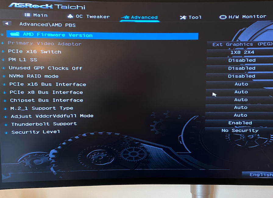

Good News! I finally got rid of the black screen and updated to BIOS ver 4.0
Firstly, in my setup I use all 3 x16 PCIE slots, one for graphics, one for 10G network card, one for RAID (Highpoint). I always assume that the BIOS would automatically configure and allocate the PCIE lanes sensibly to all cards.
Apparently this is not the case, it sort of work at ver 2.8 but got into this weird symptom beyond that.
Then I tried changing Advanced\AMD PBS\PCie x16 Switch from auto to "1x8 2x4". The problem goes away.
If you also use the other x16 PCIE slots for non-graphics cards, you may have the same problem.
I cannot find anywhere what that BIOS setting is suppose to do, just random guess. But apparently it solves the problem.
Hope this is helpful.
