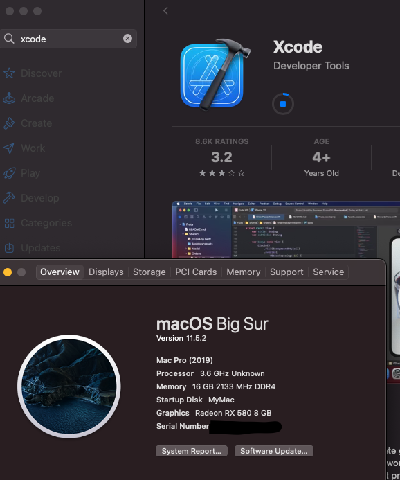

Big Sur Success | TUF B450 | Ryzen 5 3600 | RX 580
divisio
Sep 5, 2021
5
Took me a while because somehow I casually glanced over the bit about ProvideCurrentCpuInfo repeatedly.
Only special thing about the TUF B450 it seems is just that it has the RTL8111.
Audio worked out of the box surprisingly.
The only thing that seems sketchy is this:
Thanks for the guides and dedication.

Thanks, I plan on playing with RestrictEvents later.
Forgot to add, it was refusing to boot when plugged into the USB 3.0 port.
For anyone who watches it flicker at boot override in BIOS, check it's not a 3.0 port. Wasn't a problem with older OC but is with 0.7.2
