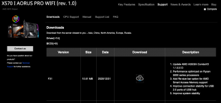

Here is my board the bios I am using(screenshot), and yes, I have tested for several times, but still the same result, I am thinking if it's really the securityboot problem, maybe there should be some tweaks to be made in theconfig plist?Screenshot 2021-01-09 at 18.53.43.png
Here is my board the bios I am using(screenshot), and yes, I have tested for several times, but still the same result, I am thinking if it's really the securityboot problem, maybe there should be some tweaks to be made in theconfig plist?View attachment 2263
It’s not the problem no.It’s set up right for the smbios I’m using.
I can’t find your error on the OpenCore guide but I’m trying to pin it down for you right now.
its a very odd error.
disconect all your drives and just try and boot to the instal page on the usb instal drive.
make sure you have CSM disabled in the bios and maybe even clear your bios by shorting the pins.
@ck_zheng I found your problem, it’s your windows drive.
Booting Windows error: OCB: StartImage failed - Already started. This is due to OpenCore getting confused when trying to boot Windows and accidentally thinking it's booting OpenCore. This can be avoided by either move Windows to it's own drive or adding a custom drive path under BlessOverride. See Configuration.
